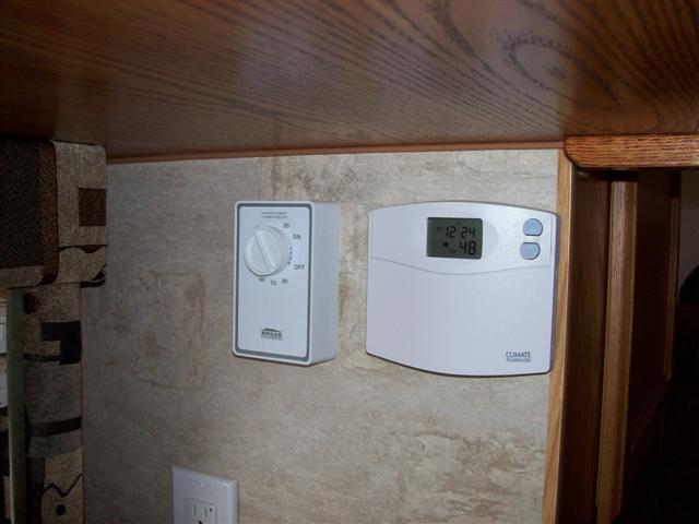

4)Digital thermostat with an off on switch at the bed. This means you can set the temp before going to bed, leave it off, snuggle under a down comforter & turn it on from the bed before you get out.

15)Humidistat that will automatically operate fantastic fan briefly overnight to remove humidity due to expiration.

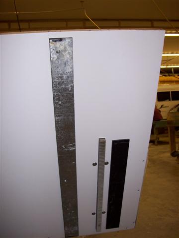

The area under the slide is reinforced with flat iron on the outside & corner iron on the inside with the wall area sandwiched in between, the tie downs are wielded to the flatiron. There is no way there will be any sagging under the slide or corner cracking .

Digital thermostat & humidistat
